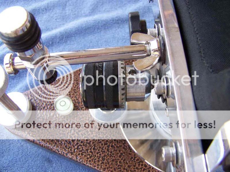

I found that for some rifles, I needed a shorter handle for my SEB rest.
An old drill (small) chuck, a long 3/8-24 bolt, a jam-nut, an old pill bottle and some epoxy made up the handle you see here.
The small drill chuck I used on the handle gave me an idea for a neat counterweight. Harbor Freight sells a larger, (1/2") Chinese-made large drill chuck for $10.00
