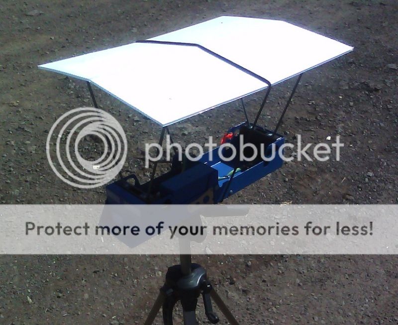

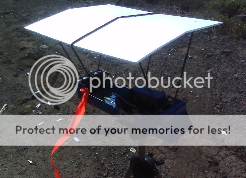

I got to try out my home made one piece sky screen today. All readings appeared to be normal, no surprises. It was a sunny day, but the angle of the sun was such that one of the sensors was not shaded.
Since I have muzzle brakes on the two rifles I was shooting today, I set the chrony 40" in front of the barrel.
Thanks for asking. My second set of factory sky screens were getting a little brittle and I kept reading about varying light conditions causing changes to the readings on chronys. So I thought a one piece screen might help. Someone else mentioned political sign material, so I went looking for some as I didn't want to wait for the elections to be over. When I stopped at a print shop, a small piece of the political sign material was leaning against the wall. I asked what the price was, and the shop owner said I could have it - free, as he just considered it scrap. I cut down the middle thru one side so it would fold and I added a shoelace around the center so the wind wouldn't blow it off.
