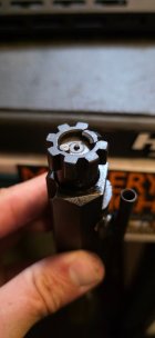

I'm well below max IAW hornady which is the manual used. I'm firing from an AR-10 semi-auto. The firing pin doesn't have e any visible damage but as far as protruding length goes I'm unsure, I will post a picture of that. Maybe try to reduce the powder charge a few grains

That firing pin looks like it sticking out an awful lot. Can you measure the amount its sticking up above the bolt face?
