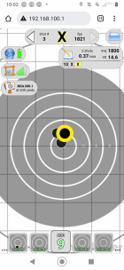

Today I ran 55.5gn in a SAAMI 280AI 140 PP PSP 3.285" OAL, it Magnetospeeded 3350 with single digit SD 5 shots. Accuracy was not competition worthy but shows potential for field use.
26" barrel.
