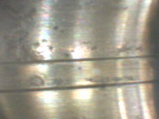

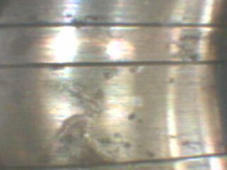

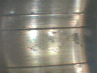

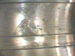

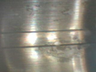

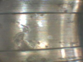

Hmmm, And how did this get through QC?
Well I will be sending a rifle back to the factory for the first time in my life. I got this .22 to possibly dabble in NRL22 shoots and some local club .22 shoots. I brought the gun home and ran a couple patches down the barrel. Tried 6 different brands of shells and settled on one to practice and begin “seasoning” the barrel. The more I shot the worse it grouped. I cleaned the barrel and decided to bore scope, Pics are not good quality but check the gouges out in the throat. I’ll not mention the maker but you can bet I’ve learned a lesson I’ll be checking every barrel from now on. IMG_5858.jpegIMG_5859.jpegIMG_5860.jpegIMG_5863.jpegIMG_5862.jpegIMG_5861.jpeg

Very few companies inspect every part. Sampling inspection has become the norm. It is likely that your barrel was not selected to represent the group. The one that was, likely passed inspection which allowed all in the group to proceed downstream.

Inspecting each barrel with a borescope would be time consuming for each manufacturer. There must be a certain level of confidence that bores will at least appear as they should that allows barrels to be made and used without having to pass careful visual inspection.
Unfortunately, despite a high level of confidence that all is as it should be, barrels get on rifles with visually sub-standard bores.

I saw the same thing on 6 barrels that were bore scoped before heat treat were perfect looking after heat treat when I was cleaning the barrels there it was. It was only out of 1 stick of barrel steel in the lot I was just about to reject the whole lot but the barrel steel manufacturer had me test some other sticks and the rest were fine, go figure.
Thats great they replaced it, my point is not 100% of the time barrel manufacturers are 100% in control of what happens to the barrel even if every single one is QC with a bore scope, there at the mercy of the steel.
