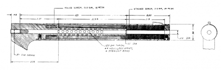

This is what the original WWII design looked like. I did see an original once and they drilled holes in the barrel to vent gas and make sure the round left subsonic. The holes were surrounded by a roll of copper or brass mesh, then from the end of the barrel to the muzzle they stacked washers made from mesh screen.
