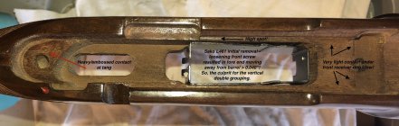

Disassembled the SAKO L461, and was somewhat surprised when, upon loosening the front receiver screw, the stock fore-end moved visibly away from the barrel - according to the dial indicator, to the tune of 0.040"!
This helps explain the persistent vertical - even with "acceptable" groups size, vertical was always the biggest measurement.

On this rifle, presuming that, upon reassembly, it still shoots about 1/2 Min. groups, especially following a reduction from 4#/4Oz. to 1#/11.1Oz., the current average is livable.;) Now, the bedding is a different story . . .:eek: RG6C2347B0-E34A-453C-97AF-AD4A2937864F_1_201_a.jpeg
Following reassembly of the SAKO .222 Mag, I fired the top 5-shot group - as usual, the initial shot was HIGH - on both groups, "double grouping" is obvious. :eek:
That was the 11th firing of the 5 Remington cases formed from .204Ruger - this barrel has tended to shoot the first cold/clean shot a little higher than subsequent shots, and also, across a two grain charge-weight range, has produced consistent vertical, albeit, for an old factory rifle, near respectable grouping. One must admit that the barrel shows potential to shoot notably better. BTW it's a 12-groove BOFORS STEEL barrel.
The next move will be to shim the metal:stock interface to reduce, or, eliminate the stress which is causing the stock to flex when the front receiver screw is manipulated. Should the shimming substantially reduce the vertical stringing, then, some pillars and epoxy will come into play . . . the following pair of pics will show where the rabbit hole leads - gotta get rid of that pesky vertical. I'm guessing that will be an obtainable goal - that last 5-shots is nearing semi-respectable . . .;)

Though the wind is a little more challenging today, shimming the stock on the Sako L461 shouts, "It's PILLAR time!" The pic captions, and pervious posts should explain . . . Interestingly, though, following F-F, the Remington .204 Ruger brass shoots quite well, the Nosler .222 Rem. Mag. brass, even following F-F, is proving more "ho-hummerish" . . . more investigation in order. o_O Perhaps this one is THE bill-fold group - next couple of days will quantify the average.. ;) RG
