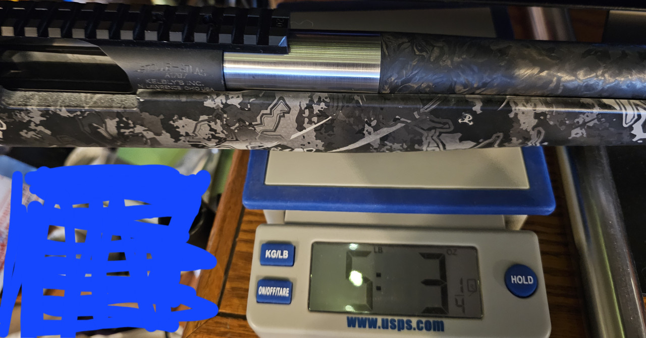

PS, I weighed the stock, barrel blank, and action and it was 5lb 3oz. Anyone have an educated guess how much the complete rifle with a 21oz razor lht will weigh?

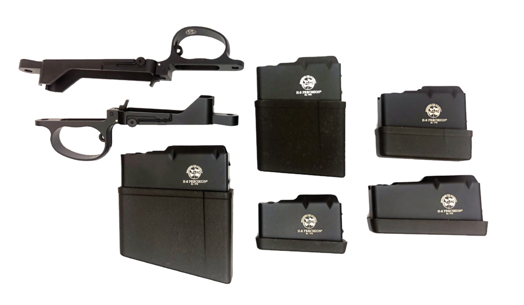

BDL flush mag about the only thing I’m aware of is HS Precision…be seated when you look at the price, they are proud of them. Not sure if they have a short magnum mag though. Wyatt’s has a system but it’s not a flush mag like you requested.

Otherwise the only other external magazine system for a bdl cut I know of is the HS Precision one mentioned above. I have one in a rifle and it works well. Not cheap but either is the Hawkins hunter system.

Hawkins and Mack both make a flush fit detachable Mag. It hangs down maybe 1/8”.
I know you can get the Hawkins for WSM, not sure about the Mack.
