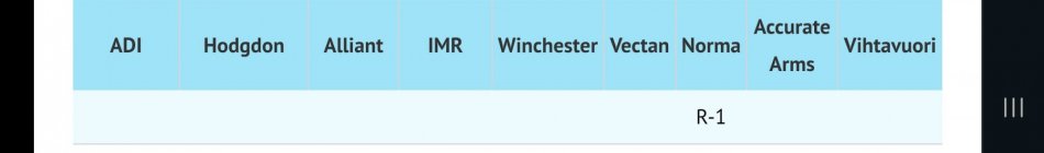

Alright, found this bit of information in my search for more info on the Barnes full copper bullet.
Hodgdon Benchmark 94.0 52.9 3.43 3085 99.7 60500 9242 0.967 ! Near Maximum
Link to thread info came from

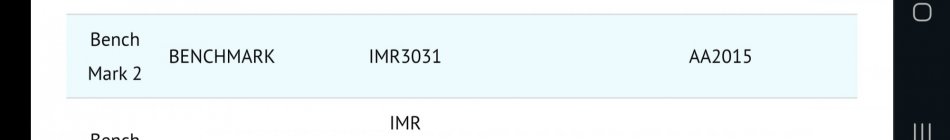

Based on the info that @Homerange sent over, it listed IMR 3031 as a similar powder to Benchmark.
Link to site here
Which brings 50.5 to be the closer charge based on that info.

Maybe you're wondering how come IMR-3031 is listed for that 130gr Barnes, and not Benchmark? They're within spitting distance of each other on the burn rate chart, after all.
There are a couple of reasons for that, the biggest being that the bulk density of the two powders is very different. Burn rate isn't everything.
