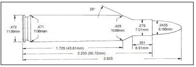

From 2007, from member Cheechako. It should if this is correct, be possible to form some cases and fireform them to the chamber.
"The 243 Rockchucker was a wildcat from the 1940s-1950s made from the 257 Roberts case with a 32 degree shoulder. From the name it's easy to guess that it was the child of Fred Huntington. For some reason Remington went with the 26 degree shoulder when they brought out the 244 Remington and that pretty much was the end of the Rockchucker. There was also a Super Rockchucker with a 45 degree shoulder. "
This was a wildcat cartridge developed by Fred Huntington of RCBS fame. The 243 Rock Chucker is basically a 7 x 57 Mauser wildcat like the 257 Roberts and .244 or 6mm Remington. You can find 6mm Remington brass around if you look. Hornady and PPU still make it. You can even find some on Gun Broker Dot Com just be careful as they seem to think this stuff is made of gold. The same goes for 7 x 57 and 257 Roberts brass. I even found some 6.5 x 57 RWS brass a while back. I use all of these to form 6mm Remington brass. It is not to difficult you just need to take your time. Once you have some fired brass from the chamber you can send them off to have a custom dies made by Whidden, Hornaday, Redding and others. This is not cheap to do so you will have to decide if it is worth it to you. I enjoy shooting some of the cool forgotten old cartridges so I take the time to figure things out. It is fun and you learn things along the way.
Below is the 244 Rem. or 6mm Remington
