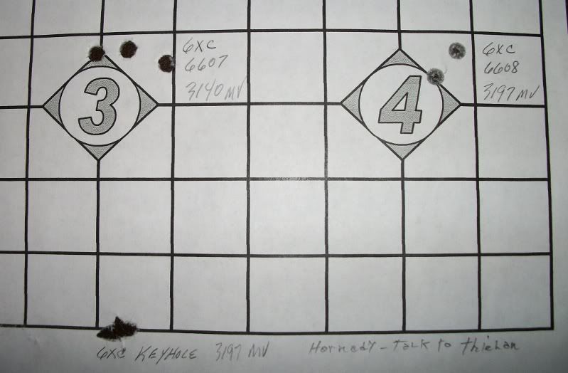

I went out today to shoot my new 6XC. It is a Savage 12 BVSS with a 28" 8 twist Criterion barrel. 17 rounds have gone down the tube before today. Today I was shooting 3 three shot groups at 100 yards after shooting two to sight back in after making a Burris ring insert adjustment. On the third shot of the third group, the bullet keyholed. Velocity was 3197 on the keyholed round and the previous two were 3188 and 3205. 105 Amax bullets.
The only thing I can think of is it was just a bad bullet.
Any ideas or comments?
Edit: The Keyholed bullet was 4" left and 3" down from the other two.

The spent primer looked normal - just like the previous ten. I didn't notice any difference in the report & recoil. The velocity was actually in between the other two like charges.
It was weird. Looking thru the scope at the group, I only saw two holes. Then I noticed this oblong hole several inches low and left of the first two holes, which were nice and round and 1/4" apart. I even pulled the bolt and looked thru the barrel. The first I did when I got back to the motorhome was clean the barrel. And I paid close attention to the first patch.

On closer examination, the second three shot group had bullet holes that were closer to 7mm than 6mm. It would appear the bullets were wobbling as they passed thru the paper.

When I saw the keyholed bullet hole, the first thing that entered my mind was twist rate. But the slowest velocity had nice little 6mm round holes. The average velocities for my three groups were 3098, 3140, and 3197 fps. I had a leftover from sighting in so the first and slowest group had 4 shots - all holes were nice little 6mm round holes with a black edge which I assume was caused by the coating. The 3140 fps group had 7mm holes with no black edge. The third and fastest group had the first two shots make the same 6mm holes with the black edge. Then my third and final shot of the day keyholed.

The middle group, 3140 avg MV, had large but fairly round holes. The holes didn't have that black edge around them that I usually see and were about 7mm diameter. Its almost like the Hornady's didn't like a particular velocity range. I'll post a picture soon - maybe that will help.
Here's a pic. The holes on the left group aren't as small and crisp as the two holes on the right group.
