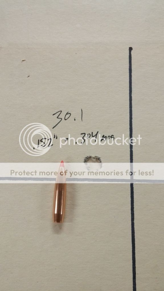

Well I got some of the 105 Amax loads to the range, .010" jump, 29.5 - 30.3 Varget. Unfortunately the local range is only 50 yards but still got good results. Everything except the 30.3 shot well, the 30.3 was over pressure, even blew one primer. Best group was .15" or .3 moa (5 shot group), average of the groups omitting the 30.3 over pressure loads was .46 moa. If I'm being honest even with my NF benchrest scope my eyes and trigger finger had to work pretty darn hard to get that .3 moa group, essentially I'm not sure if I have the ability to out shoot the Amax bullets however I'm definitely going to try some VLD's at some point. If anyone's curious I shot with a Rempel bipod and Edgewood rear bag.
I'm likely going to settle on about 29.7 grains of Varget, now I need to play some more with seating depth. If I can keep my real world average below .5 moa (not just the pinup groups) out of a stock Savage barrel with no action work except for bedding with $.25 bullets I'll be tickled. I could also do better with 3 shot groups but I'm one of those guys that believe anything under 5 shots isn't a group.
You will find that your accuracy will drop as ranges increase due in most part to the inability to hold on the same point of aim exactly as the round is fired. I do like the one hole group even at 50 yards. I use five rounds to make a group but I know a lot more people like 3 shot groups.
