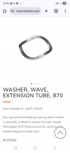

I have that exact same gun. It was a KMart special. It is a 870 and most parts exchange no problem. One thing you will see is the new barrels do not have the detent on the ring to lock the barrel nut. All the express guns don't have it it so you will either need to find a older actual 870 barrel or you need to get a wave washer from Wilson combat. It will help lock the barrel nut. That and the magazine cap is the only difference.
This washer

YES that is the washer you will need if using the new barrels. If you look on your barrel, look where the ring goes over the mag tube. You will see the little ball bearing and how it locks into the mag tube nut. The nut has dimple all around the flat surface. The new barrels do not have that. It locks the nut by the mag tube spring clip that holds the spring in the tube.
