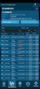

Here:
Read Post # 8

Half of a 85.5 Berger is seated in the brass and I’ll bet some of the ogive. That’s a really long bullet to load to 2.26. I load them for my 223AI at least 2.560.
I would As KARARARARAR stated not try them at mag length, those are a single load long kind of projectile. Start at Touch and Jump test. Some have success while others have not. The 80.5 may serve you better.
I also would not recommend the 85.5's at mag length.
