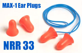

These MAX-1 nrr33s are the quietest ear plugs I have tried -- and I have used just about every brand:
http://bulletin.accurateshooter.com/2013/06/recommended-gear-howard-leight-max-1-nrr-33-ear-plugs/
Between shooting, riding motorcycles, and working with gas-powered yard equipment, I probably have foam plugs in my ears 8-12 hours a week. These MAX-1s, with their bell-shaped flared end are very quiet, but also comfortable.
Muffs over plugs will reduce noise even further. But, as JRS noted correctly -- you don't "double the NRR rating". But good-fitting, quality muffs placed over plugs will provide a meaningful reduction in sound energy -- and every bit counts.
