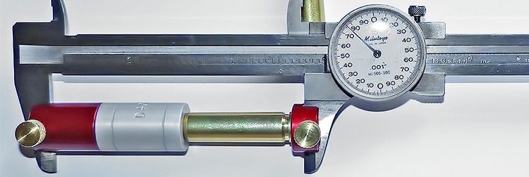

Do you even have a way to measure unfired and fired cases?

You cannot provide data unless you measure the unfired cases.
