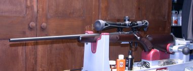

Have My 457 (22WMR) Ready For a Fair Test
I have the 6.5-20X44 Vortex Viper mounted to the 457. I tested that scope by spending a day with it mounted to my Anschutz 1761. It passed with flying colors. It is now my best varmint scope. I also have a box of the Hornady 30 gr. V-Max that so many RFC members have urged me to try. So. I believe I can be sure any accuracy issues will either be me or the rifle.
Now I just need to wait out the current rainy spell and head to the range. I have been getting one or two dry days a week, so it should not be long and I will be posting results.

I could not be more disappointed. With the rifle and scope you see in my picture, along with my best front rest and rear bag and a couple of boxes of the Hornady 30 gr. V-Max that everyone said is the best ammunition for my CZ, I spent a day at my club shooting at 100 yards.
I was immediately on paper. It took only a few rounds to get somewhere near my point of aim. Then came a series of some of the worse 5-shot groups I have ever made with any rifle.
I pilled out my torque wrench. I checked my scope, my rest, everything I could think of. Nothing helped. When I was finally done shooting one box, I took my target down and measured my groups. The average was well over 4"
When I got home and set up for a serious cleaning I found excessive fouling in the chamber, with the bolt face covered in a thick black layer of carbon. In decades of shooting with dozens of rifles, I have never seen such a thing. I have owned cheap rifles that shot far better than that.
I will be heading back to the range this Friday with a variety of different ammunition options. At this point, I am completely stumped.

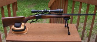

I don't know about that, If 222 Rem and 220 Swift were not too much and 243 Win. was not too much, I cannot see how 22 WMR could be a problem. Then there was the time I got to shoot 50 BMG. Now that was recoil.
This was my Ruger No. 1V in 220 Swift. I really miss that rifle, even though it was a powder hog.
