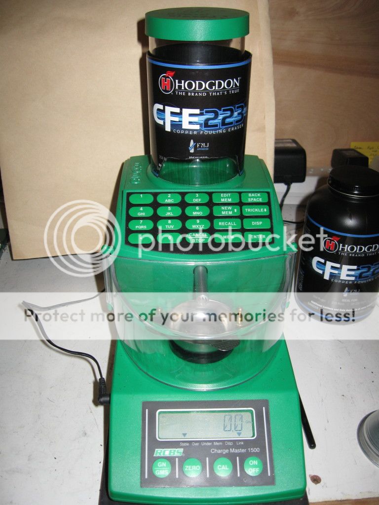

Have an empty powder container and nothing else to do for about 10 minutes?
This happened to me yesterday afternoon and this is what I came up with.
Cut the bottom and top off, opened a small "window" at the bottom to see if I was getting low and now there's no question as to what powder I have in the reservoir. Don't have to leave a bottle next to it to remind me.
Also, although I live in the PNW where Sun is a rare commodity, the black plastic bottle material does shield the powder from what little sun we have.
Works great with Hodgdon's family of powders, not so much with others that use square bottles >:(
Now all i have to do is go find some empty 1# bottles for the powder(s) I buy in 8# jugs. This one was left from my recent test of CFE223. Tuesday my order will arrive with it in 8# jugs.

I do something similar when using 1 lbers.
Dump the powder in the hopper. Screw the cap back on the 1lb jug and invert it on top the hopper instead of using the green cover.
Like you say, I always know what powders in there but theres no cutting involved.
