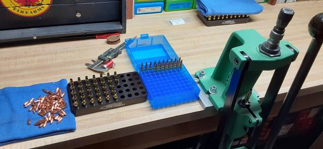

I've been handloading since 1968 and have had similar experiences with at least three manufacturers. Now when loading either rifle or handgun bullets, I spread the bullets out on a shop rag prior to seating. It's easy to see any that are not the same as the others and cull the offending culprits before getting anywhere near a case full of powder.
Since doing it this way, no unexpected bummers and no blown-up guns.
Started doing the same decades ago because we were getting hoards of 2nd's from Nosler and bulk from other places for our sage rat activities, just nice to be able to give them a visual before loading. Nowadays I do it as much to prevent handling any more than just to seat them, especially the custom ones. Easy to dump the excess back in the box without touching them so they stay nice and shiny.
Oh and yeah to the OP's topic, I have found odd bullets over the years but luckily always very noticeable.

When I'm ready to seat bullets, I only seat a dozen at a time. I line up 13 bullets sitting upright next to the press and have a look at them to see if anything looks "different". If not, they get seated, then I line up 12 more sitting next to the last one from the previous dozen. This hasn't failed me yet.
I also weigh the first bullet out of a fresh box, and measure its diameter.
