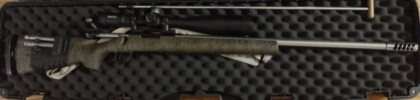

The pic shows the Limbsaver I use, it works well. Installing a lighter spring has the biggest effect on comfort.
