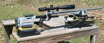

I use aluminum chassis exclusively. 3 big factors......Do you sling/
freehand ??.....Shoot from a bipod ??..... Or fully rested in sand bags
fore and aft ?? I use MDT aluminum chassis as a platform for my
builds. I do a 3" wide fore end that gets laid upon a soft sand bag
on a 31 lb rest. Butt stocks are 1.25" wide and flat, and nested into
a heavy sand Bumble Bee bag. I shoot unlimited where my 2 rifles
very from 17lbs to 21lbs. So, you have to consider all the aspects
before dishing on an aluminum stock. I've posted this before, so for
anyone that has not seen it, this is what I do for aluminum stock
fore ends......
Funky bench just used for dog and pony pic.
