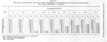

I worked with a PHD metallurgist that was a consultant to the copper/brass industry. He told me when the brass glows orange it's at 1050F. Depends on your interpretation of how bright the orange is?
You keep seeing basement scientist saying anneal to 750F. No-one seems to know where this number comes from. All published data generated by College labs shows no hardness change at 750F for as long as 15 seconds. I believe my annealing only stress relieves with very little if any hardness change. Let the flames begin.

450C = 842F. All the data in the chart is 450C. The shortest time presented is 30 seconds at temp.

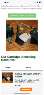

I do “manual” annealing after each firing, using propane torches and metronome, all equipment from anneal-rite.com (attached).
It’s not expensive and the primers you reload with are probably much more dangerous than the propane torch— I keep a fire extinguisher close by.
