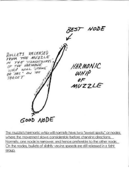

The optimum release time is when the barrel is just short of its apex on the upward vibration cycle. Slower bullets will exit at the dwell area at the top of the wave.
This has always been my understanding as well. At either end of the arc of travel, the movement of the bore should be at the slowest of any point in the cycle because the bore/muzzle will reach the end of the arc, hesitate momentarily, then continue back along the arc in a different direction. Bullets released in the region of the high end of the travel arc and, to a lesser extant the lower end, will be the most stable with respect to velocity variance because the bore will be moving at its lowest average velocity at the apex of the arc of travel. For that reason, the bore will exhibit the least amount of movement over time at that point and bullets will be minimally sensitive to velocity variance.
In contrast, bullets exiting the bore in the middle of its arc of travel will be released when the bore is moving at its fastest rate of any time during the cycle. Therefore, they will be subject to greater bore movement, and hence, changing POI, for even very small changes in velocity. In terms of bore movement, the most stable load should be one where the point of exit is at the ends of the barrel arc of travel. Below is an image taken from a post by Dan Newberry (OCW Testing Method) that illustrates this concept nicely:

Got my orange jumpsuit on for when everyone throws tomatoes at me, but here's my .02 on "nodes." I recently shot a match and velocity in the morning was 2670 (SD 6) right where it should be. Later in the day (sun out, much hotter), average velocity was 2720 (SD 6). Rifle shot great both strings... I'm not a big believer in finding sweet spots. I am a big believer in putting as heavy of a contour as you can manage on the barrel so harmonics are not as important. My "load development" consists of finding a "node" where the velocity changes are minimized as the amount of powder is changed. Beyond that, I think it's more important how well you prep your ammo versus finding some magical sweet spot. Of course, I'm probably wrong and just rationalizing my laziness and general disdain for load development:D
.... I like to just think about what the muzzle of the barrel is doing when it completes an up down vibration cycle. One would think the objective would be to catch the muzzle in the perfectly flat position, not pointed up or down. But there are really two flat positions; one with the barrel moving up and one with the barrel moving down.

Actually the whole purpose of tuning a barrel to a bullet velocity is to compensate for variations in muzzle velocity. A barrel moving upward in the vibration cycle is what we are looking for. We are not looking for a stopped barrel. There are some in the rimfire world that think a barrel tuner when properly set up "stops" the barrel, and once tuned the gun can shoot any ammo velocity at any distance and the barrel will still be tuned. Not true. Barrel tuning in a rimfire by changing the tuner weight and location to change the vibration frequency of the barrel is just the reverse of having a centerfire barrel with a fixed vibration frequency and changing the velocity of the bullet.
A fast bullet will exit sooner in the vibration cycle, while a slow bullet exits later. If you use an average target velocity that gets to the muzzle when the barrel is on the upward vibration cycle a fast bullet exits with the barrel pointing lower. A slower bullet exits with the barrel pointing higher. If you choose the right part of the upward cycle the normal velocity variation from bullet to bullet at the same load will be compensated for, and the vertical variation reduced.
As far as where the exact right spot may be could be (just my theory) at the 1/3 up position (velocity), and then another similar one at 2/3 up. Right at 50% up where vibration vertical velocity of the barrel is at a maximum, may be too much. This is probably where you see a dip in POI increase with velocity increase. The ideal spots may be just before that or just after.
So getting back to the OP's question, yes there may be two "sweet spots" fairly close together separated by an area where there is some over correction. But remember, you have to go all the way around the clock with increasing velocity to get to those spots again. So if we categorize the vibration cycle crudely into a clock starting at 12:00 you will have a bad area which peaks at really bad at 3:00 and goes to 6:00. Somewhere between 6:00 and 9:00 there will be a sweet spot, then an over correction zone at 9:00, followed by another sweet spot between 9:00 and 12:00. In some cases there may not be a dip or it is very minor at 9:00, and there is quite a wide sweet spot.

My point was simply that when considering the effect of barrel harmonics on directionality of the muzzle (and therefore POI/precision), the ideal point for the bullet to leave the bore is when the muzzle is moving at the slowest speed, which should be the point where the rate of movement/directionality of the muzzle is minimized and therefore provides the most consistent and stable POI. That point will be at/near the ends of the arc of travel, not in the middle, and not partway up in the cycle.
OBT is a whole other ball of wax. I use it and it has worked very well for me and many others, but I cannot say with any certainty that Chris Long's explanation/mechanism is either the correct or complete explanation of what is going on. What I do know is that I have had success using it as a loading approach, so I will continue to use it whenever possible.
