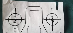

Had to sight in the 17 hornet.
ohlongarmisle

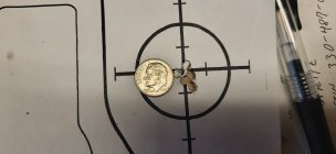

I've been using a Hornady 15.5 grain NXT at 3810 fps for three years now, it's no longer available and I won't pay $2 a round for it on Gunjoker, so i'm using Hornady 20 grain Superformance at 3610 fps. Two groups at 100 yards 5 shots each , right hand target threw one shot low right.Both groups are less than 0.5 moa. Ok for a stock rifle.The group on the right measured .435, the left .290, the commander on our swat team measured them with calipers the way you're supposed to, as for now no aftermarket barrels.

I’m gonna assume it’s a CZ 527 based upon the great groups
That's correct, stock rifle everything even the 1 pound set trigger.I've thought about a Pac Nor match barrel for it but am wondering if it would do that much better, hopefully hillbilly long rifle can interject as he's an expert on these mouse calibers.
Yours shoots pretty typically. Considering the 17 Hornet’s effective range I don’t know what would be accomplished for real-world shooting by spending money to try shaving off maybe one tenth MOA.
You're 100% correct , I sent some of my groups to a couple very reputable barrel makers and they told me save you're money. Mind you that group was shot in a lead sled no wind 80 degrees high humidity, but still good shooting, haven't missed many varmints in three years , that's for sure.I limit shots at 250 , and have been satisfied , there's always the 20 cal for extreme long range.
250 is pretty easy with that setup. If/when you finally burn the factory barrel out then a custom barrel will be a fun upgrade
I've got 250 rounds down the pipe in 3 years , 95% live targets.I imagine with cleaning regular 100 rd life , don't really know.

I'm using factory ammo only those groups were shot with Hornady factory, I don't reload. I sent those groups to Lilja, and the owner said leave it be, it's a shooter honest company.Pac Nor same response, I got lucky. Standard sporter barrel.
The Hornady factory ammo shoots better than my hand loads, I'm sure it is what I'm doing not the Lilja barrel. Many would be happy with the groups I'm shooting, it just I had better groups with other guns. Like many I need more brass.

I'm not going to touch the barrel, and the stock set trigger adjusts to 1 pound which is where I have it, the 17' hornet is not tough on barrels from what I know, only about 300 down the pipe so far in the 3 years I've had this particular one.All on varmints and brief sight in.As for the brass I can't even get 75$ for 250 pieces. Thankfully I stocked up on plenty 20 grain Superformance.I had the swat team supervisor measure this at work with calipers.I don't believe any barrel out there would outshoot it, everything came together under perfect conditions. I threw one shot low in the right hand target but knew it.I don't plan on missing much, but haven't seen one gh yet today.
