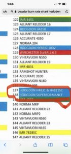

In my one experience with the two powders they weren't the same. In a 25-06 shooting 115 Berger VLD's the H4831 SC was almost 100 fps faster. Great accuracy and IMO easier to work with than the non SC.
Not according to Hodgdons burn rate chart
