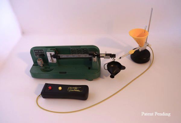

RCBS Powder Trickler 2​
OR…
rs=w:600,h:600
https://dandyproductsllc.com/products/dandy-2-speed-electric-powder-trickler
