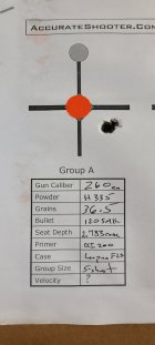

Follow up - loaded up 5 rounds or various charge weights both by weight and then did the same last using volume using a redding 3br measure.
Huge improvement noticed with the loads utilizing volume vs weight.
Overall powder worked very well. Think with the accuracy in seeing using h335 and the fact I'm below max pressures I should be OK. Going to still measure speeds and SD. Positive results so far.
