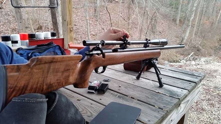

We put ours in a new stock, more similar to an Anschutz Supermatch design and it's a great improvement. It shoots just as good as our Win 52-C and 54 Super Match at our long-range rimfire matches.
Not a great trigger but I'm not trigger sensitive and can live with it. I'd sure like to find another one, think they are a highly under rated target gun.

any info on the stock????
Got it at Richards microfit, it is not listed as being available but if you call they do have the inlet for a model 12. It's also available with a thumb hole in this design as well as others. This stock was semi-fancy and was about $160.00 shipped.
It was 90% inletted and took very little tweaking. I had to inlet the bottom of the forend for the accessory rail and also opened up the action and 2 inches of the barrel channel 1/8" so we could bed it. I also ran the ball mill into the front of the cheek rest slightly so the bolt had more clearance when removing for cleaning.
