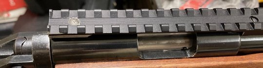

Has anyone shot their rifle with the mount installed yet? I'm having intermittent ejection problems. Sometimes the fired case bounces off the angled part of the mount and the fired case falls back into the receiver, facing both forward or backwards . Then other times it ejects the case normally.
SK ammo is being used. Does it whether I work the bolt slow or fast. The rifle was NIB/unfired when I bought it. Shooting it before mount installed worked like it should 100% of the time. Any idea's on a fix?

Does any part of the mount cover any portion of the ejection port???
Pic of the right side, might help....

Can you see 'markings' where the brass is hitting???
No brass marks, but the brass definitely is hitting the under side of the mount as viewed by another shooter at eye level with the chamber area. I even moved the scope ring to the front of the chamber area which didn't help.

Looks like it could be the ring base. Personally I don’t care to see the bases near the port anyway if it can be avoided.
If you have one, use your phone or a friends to shoot a close up video while ejecting. You can enable a slow motion feature on the iPhone that may help. You can scrub the video back and forth to help see where/how the problem occurs.

I had already moved the ring to the forward slot on the rail, over the chamber and they still hang up now and then. My next move will be to have the port area of the rail underneath milled down .067/1/16 and increase to .125 if the brass needs more clearance.

The port is too small this is why it has ejection problems. I made my own mount, and it had zero problems. note how much more open the port area is. you need to mill the area bigger.

I had the underside of the mount recessed .125 and the problem still exists. I'm now wondering if the problem is due to a very stiff moving right side extractor. The left side is a lot looser than the right so I may swap out the springs to see if that helps.
I also noticed that the ejector is screwed in from the bottom and wonder if it can be adjusted up/down.

The loading tray is held in place by the screw. the ejector is part of the tray. FYI, the lug that acts as the bolt stop on the bolt may drag against the tray if you raise it.
