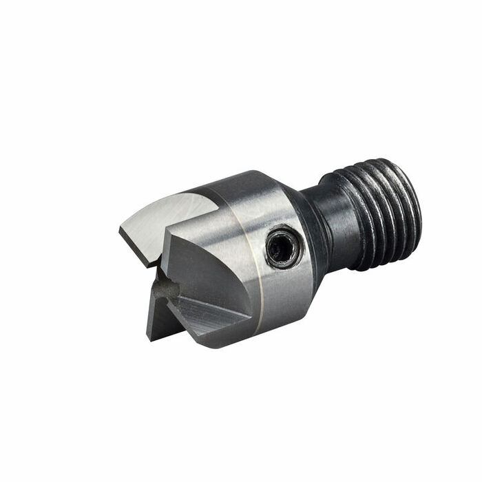

For the VLD type chamfer I'd get this one:
For deburring I'd get the hornady 4 blade. It's the nicest out of the 3 I have used (lyman, rcbs, and hornady). This tool is threaded the same as the lyman chamfer tool. So you can use both with one handle if you want.
