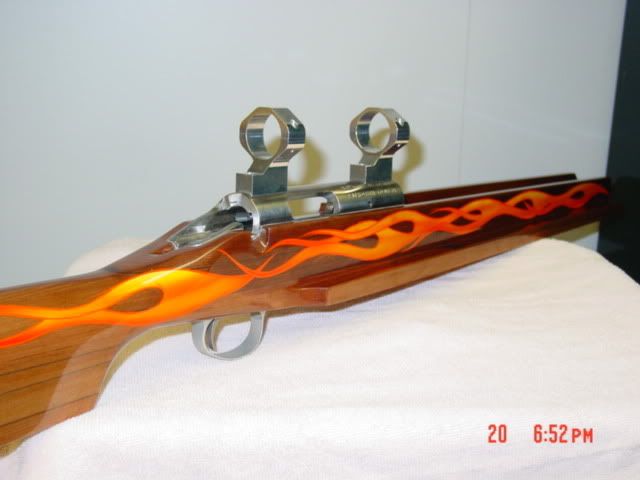

My brother in law does custom guitars.
He did one in a nice maple with great figure.
Sprayed with a blue candy with a lil extra highlight on the edges.
Freakin beautiful.
