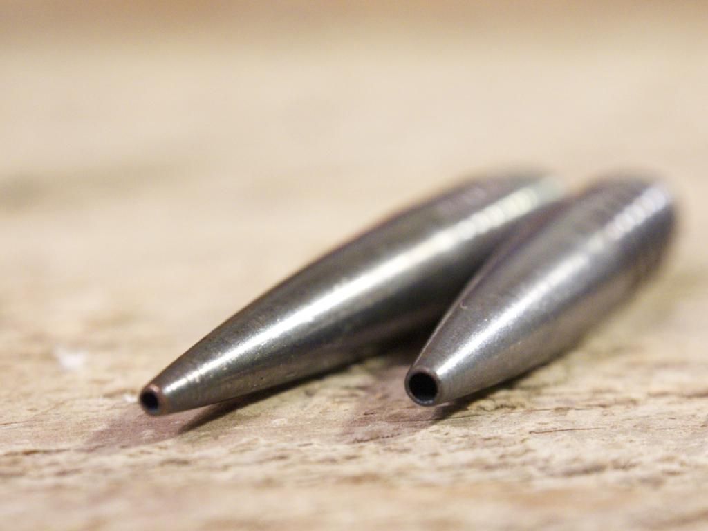

Here is what I purchased.
100 of the 165gr HP expand bullets for hunting.
50 of the 186gr HP expand bullets for hunting.
So I feel way out of my league loading these. They are monolithic so pressure and powder choices are way dif. Not to mention they are molly coated and I have never tried a molly coated bullet before. So here are my questions. Hope I am not asking to many, I just feel a little intimidated by these.
1. What sort of powders should I use? I have a list from there website for these bullets. I would like a powder that burns pretty clean and is reasonably temp stable.
2. How do they tend to take to pressure. A reloading buddy of mine used some Barns Monolithic bullets once and even with book minimum he was getting 2900fps with a 200gr bullet over just 46gr if IMR 4350. Needless to say those were dangerously hight pressured and I don't want to blow my head off.
3. How about cleaning routine? GS Custom also sent me some of there M98 bore cleaner. By the label it appears to be a coper fowling remover.
4. I can't even think of how to start with these. Really any experience you could share with me would be greatly appreciated.

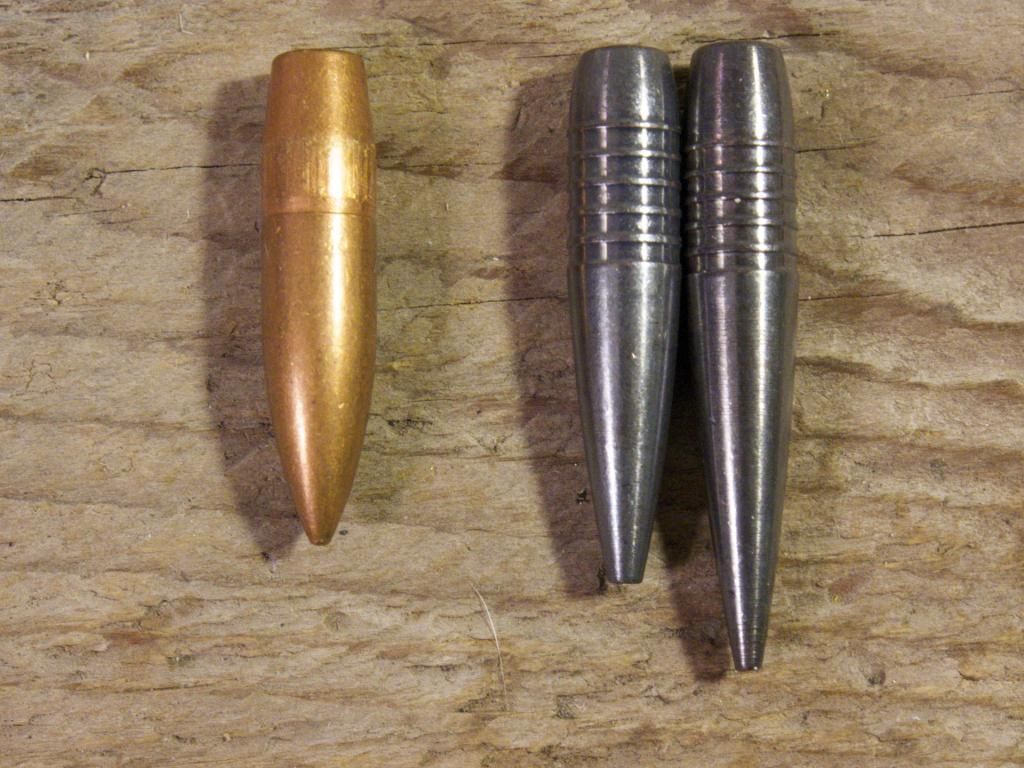

Everyone I know who has started to load with Gerard's bullets has been at least slightly intimidated at first. But once you've achieved some experience with this style of bullet, you become more comfortable.
First of all please note that these are drive band bullets. The lands only engage the drive bands so the contact with the lands is minimal when compared to the standard cup and core bullets or the Barnes monolithic solids. The rest of the bullet is bore diameter or less.

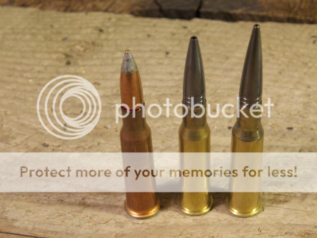

Ok here is a summery of my GS Custom 165gr bullet test.
The Gun I chose is one that has NEVER shot very well. It slugs at .313 on one side of the slug and .3135 on the other. So the bore is oval shaped. It isn't centered either. The freebore is really good though. I can seat bullets at just 3.308in to the bearing surface of the bullet. It was probably a gun that never left the arsenal. It was mint condition in every way.
I have tried many bullet and factory loads in it. SMK 174 shot ok at about 1.5moa. I also tried 150gr Sp Sierra and they shot a little better at 1.25moa. This was after a lot of testing and load development though. I have been feather frustrated with this guns poor performance as it shot factory ammo at about 3moa. So the gun just doesn't shine even though the bore was in like new condition.
Today I tried some of the new GS Custom 165gr bullets that are designed just for the Mosin. I got to say it is an amazing bullet. In this disappointing gun they can still shine. Like the sun! Even though not one of these bullets was the same powder charge, I was doing my ladder test, they still made one hole!
So here is how I loaded them.
I used CCI 250 large magnum primers.
Brass was once fired PPU
For powder I got some Vt N530 the stuff burns supper clean. I love it so far.
Then I loaded 12 rounds. Each in 1gr increments. I started at 41 and worked up to 52gr. I only shot five of them because at 45gr is was beginning to see plenty of pressure signs. When you the reader start doing this I recommend starting at 40gr and working up no higher then 45gr, some barrels may be able to handle 46gr but work up 1gr at a time. I chronographed them and only got reading on the first three bullets. Here they are.
41gr 2458
42gr 2523
43gr 2588
44gr -
45gr -
Unfortunately my Chrono failed the last two but I think if they were continuing to increase in speed like the first three then 45gr was running at 2718fps. I have a very short 22in barrel and thats pretty fast. My PPU 150gr soft tip bullets only get 2678fps.
I think with some Lapua brass I may be able to get a little faster of MV, but for now this gun is in every way ready for hunting season.
To summ it up. Always start your load development at the bottom of the recommended charge list. For this one I recommend 40gr. Check for pressure with ever new and bigger charge. When you see pressure signs STOP. Pull your bullets that are loaded to hot and live to kill that trophy deer.
