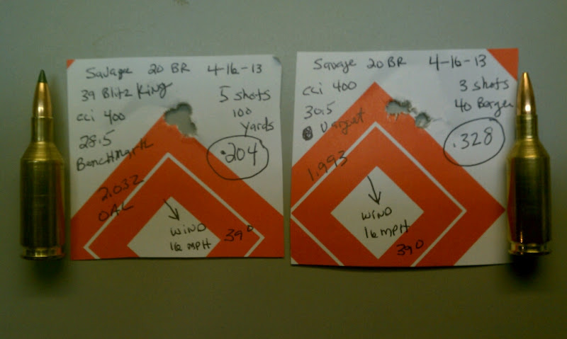

I took my 20 BR to the range today to check zero. I have a chuck hunt this weekend. The wind was almost dead in my face (around 11 O-clock) and 16 MPH according to my wind meter. It was overcast and brisk with a temperature of 39 degrees.
My clean cold bore fouler went just right on the 40 grain Berger 3 shot group. This load typically shoots in the mid .3's to about .5 at 100. I then switched to the rifles favorite load and shot a 5 shot group at .204! Serendipity, I sure think so. Those chucks are in for it!

Lookin' good. I'd stick with the Varget and 40 Berger load, however. Except for that obvious cold bore anomaly it looks to me to be better than the other group.
