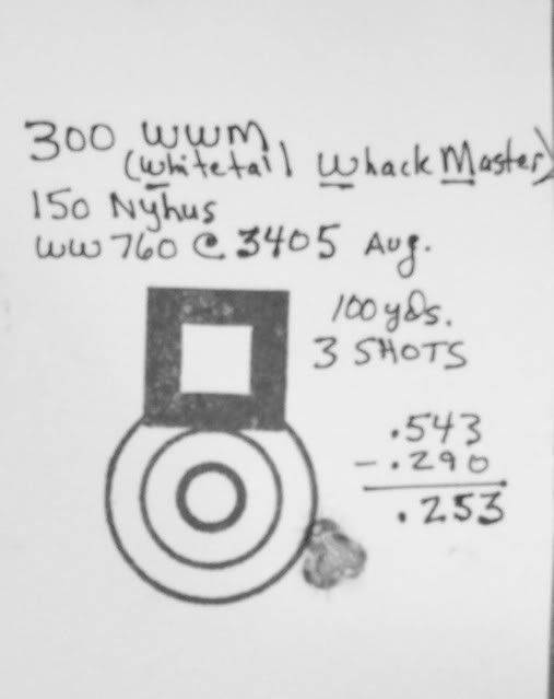

Bullets don't make caliber-sized holes in the paper. Because of this, it's best to measure a single bullet hole in the paper and use this as the 'standard' for subtraction.
Measure the widest spread outside-to-outside (including the 'smudge' around the bullet hole), then subtract the single bullet hole measurement for the total group size. This will get you with a few thousandths of a true a group measuring device. Here's an example:
Agree with Al in that you need to subtract the single hole size from the outside group size. You also need to use the same technique for measuring the single hole as the group. This nulls out your measurement technique to a good extent. Here is a target shot for a fun match. The requirement is to shoot four singles, measure them all, and average them. This average is subtracted from the outside group measurement to get the true center to center group size. These are .22LR holes, and as you can see they are not 0.223", but more like 0.206".
