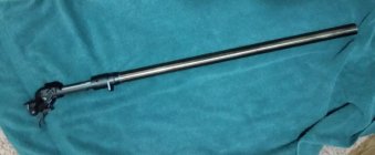

Project Update
The ID to OD run out was less then .002 tir.. We decided to go ahead and thread the OD.. When we get ready to chamber it we will switch to a 4 jaw chuck and indicate the bore prior to reaming. We will have the chamber and the bore in line with each other and the od will be .001 off with the bore center, and we should be good.
I am glad that GM kept the bore and OD that close to each other. I was a bit worried after reading some of the above thoughts, which were valid, i ddn't have much room for OD to ID mismatch.
