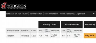

Thanks bullet weight 229.3 gr hodgdon titegroup says 4.8 grains of titegroup

Presume you know what you’re doing, so forgive this precautionary post. 4.8gr is listed as maximum load for 230 gr FMJ. May be fine, but best practice might be to load a bit under that (10%?) and work up to ensure safety in your pistol. No offense intended. Be safe and have fun.
Thanks I always err on the side of caution, always check my weapon, make sure everything is cleared if not I do it myself, had a buddy use one of my ARs long time ago he was trying subsonics, I guess he wanted 2 quick shots,I was stupid to let him use my gun never again he destroyed my upper,round didn't exit the barrel second one destroyed the upper.
