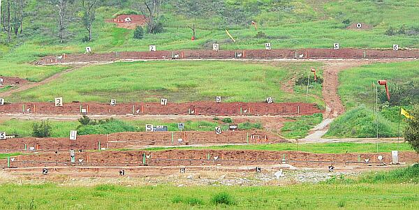

Here's Ojai, looking out towards the 600-yard berm:
We also have a 100-yard "fun benchrest" match every month. Interestingly, the best 600-yard guns have done pretty well at 100 yards too.
