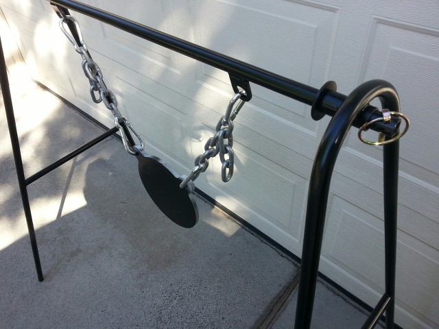

I made a gong swinger for pistol shooting. No big deal, easy to make and el cheapo to boot.
Along with my 'combat silhouette' falling plates, it makes for a good informal pistol range. Better commercial units can be found for sure, but with a zero cost factor, this is working quite well, thank you. :D

nice stand. did you bend EMT, then weld, and paint?
Yep, my son has a nice fab shop here, so a few minutes on the bender, a few more with the TIG welder, used some scrap AR500 for the gong, some spray paint, and wha-la, my very own pistol swinger.
I had to weld some 'feet' with holes to put some tent stakes in it, as once you get the rhythm going, I could knock the thing clear over. Once staked to the ground, problem solved. When I shoot my new Kimber Aegis Elite Custom 1911 9mm with the Vortex Venom 6MOA red dot, the speed I can deliver rounds to the gong surprises even me, so anchoring it to the ground was absolutely needed.
Pull-pins allow it to fold flat for transport or storage:
Best part was the price! :D
