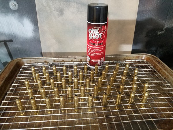

I set the brass up like this and spray 4 angles with the can pointing downward 40-45 degrees. last 50 cases I sized I had waited a few hours after applying and found the case was grabbing a little when coming out of the die. I was bumping necks .0015-.0025" and the grab was enough to negate most of the bump, so I started applying Imperial and was back in spec. My guess was I was too thrifty on the application of the last batch.
The baking pan and cooling sheet work well and go in the dishwasher afterwards.
