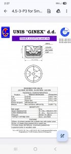

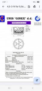

I've been thinking about trying Ginex in some of my well used practice brass as well. My concern is I currently stick with cci 450's due to the cup being thicker and tougher than other srp's that I've tried. Ginex makes 2 versions of small rifle primers. Which one do you use, and how would you compare their resistance to blanking to a 450?
Use the 556 4.5/3N. They have a thicker cup. I have blanked ( pierced) the small rifle.
IMPORTANT; call to find out which exact model they are selling!
I ordered form Tactical Shit.com. they clearly advertised 556 primers but sent a case of small rifle thin cup primers! No returns.
I use the 4 , 5/3-N for 5,56 primer from Ginex . It is the only one I have ever seen available in my area as a SRP .
As far as comparing them to a CCI 450 , I can't , since I don't use any CCI primers , Large or small .
I am shooting them in a Kelbly .308 Action , and have never had one perforate , or "Blank", and they have done well for me . @46&2 supplied all that beautiful data , so I'm sure he answered most of the questions with that .
My normal primer ; both Comp and practice for the last five years has been the Rem 7 - 1/2BR , which has a thinner cup , so it stands to reason that I would get pierced primers from them before it would happen with the Ginex . Hope that helps .
