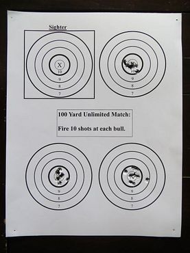

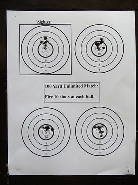

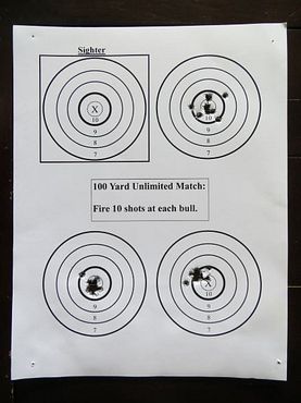

Below are ten consecutive 10-shot groups at 100 yards. The ammo was a good lot of Midas +, the rifle a 1973 vintage Anschutz 1411 barreled action in a factory Anschutz BR 50 stock, no tuner. The targets were shot for group size, with the ten group average at just under 0.800 inches. (The outside dimensions of the dark black ring are are shown.)
Clearly, there was some unaccounted air movement or the ammo was not always equal. Add the rifle and shooter to the equation and the results are imperfect.
