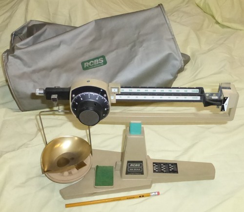

Getting a RCBS 10-10 calibrated

I own two 10-10's one is a little rough the other is very good. I recently purchased a Redding #1 from Scott Parker and used the Redding to check the accuracy of the 10-10's. The rough 10-10 needs some work! If you would do a search of older forms I think it was member Boyd Allen that posted a very informitive post on tuning the 10-10. I am searching for a good deal on an M5 to add to my collection.
I am interested in getting my RCBS 10-10 calibrated but from my research this scale is not USA made scale. I bought this scale used. What are the sins of the non USA 10-10 scales that makes them not worth the time ore trouble to calibrate?
I check my scale with a piece of sttainless steel I made at work to weigh about 33 gr. I weighed it on a lab scale to many decimal places and rounded to 2 places. Engraved the weight on my standard. It doesn't matter if the scale reads 30.0 gr and it's actually 30.1. As long as the weight weighs the same amount each time you verify your OK. I load for accurate varminnt rifles. I also put a drop of oil on the agate bearing. Just keep it clean.
Hello Webster, use some graphite shaved from a lead pencil for the agate bearings. Get that oil outa there it builds to a gummy mess. Check the older forms for the Boyd Allen post on beam scales.
I actually talked to Boyd and he had some very good suggestions on tuning my 10-10.
RCBS makes check weights if you're picky about absolute weight. I had some back when I used a beam scale and found that they were not needed.
No reason to assume oil gets gummy with time. Cannot imagine my car running on gummy oil. An eyeball check will verify cleanlyness. Movement of the metal piviot may push graphite out of the contact area? Pencil scrapings are not as fine as purchased graphite. Lead pencils are not 100% graphite. The graphite is mixed with a clay for a binder.
