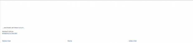

Went to the "Riflemansjournal" archived site to find German's break-in regimen and discovered it has gone AWOL. If anyone has a downloaded copy can you upload it? Thanks in advance.
He wrote an article titled Equipment: Barrel Break-In
It was a gag, meaning the page was mostly blank and the bottom line said, "and that's all there is to it"

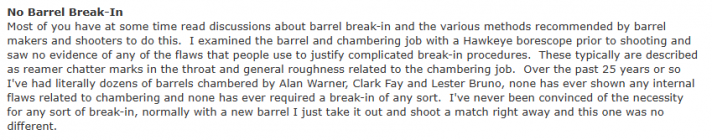

Here is another quote from an article called Breaking In the Bat that is shown at the bottom of his Break In article.
http://riflemansjournal.blogspot.com/2010/08/equipment-breaking-in-bat.html
It has been a while since we have lost him, so if he wrote a different one give me some pointers and I may have it? German was a personal friend, and as I recall, he didn't believe in barrel break-in, he just started shooting at 300 to 600 and got a barrel started. Remember, he was a sling shooter so with less sensitivity than an F-Class and in those days it was a PIA to set up a chrono on the line. By the time he shot 1000, the load was worked out at 300 and 600.
