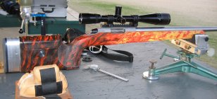

I’m familiar with automotive finishes and have sprayed a fair amount, but the idea of gel coat has piqued my interest and I could use some guidance and direction. What brands of gelcoat and colorant are popular? Two coats? One thick coat and dry it on a rotating stand like a fishing rod? No wax on base coat and then wax on second coat? Spray on a mold release on final coat instead of wax? What kind of sprayer? I have a decent 3mm cup gun, but it’s not pressure fed. When multiple colors of splatter are applied is that with a normal gun? Two guns?

I was under the impression stock makers commonly use gel coat as an exterior finish - for both high gloss competition stocks and earth toned splatter finished hunting/“tactical” stocks.
