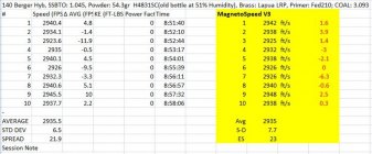

When I did my test for Garmin vs MagnetoSpeed V3, I didn't get that much difference and the nearby shooters with their LR's, the velocities were also pretty close to the same as the Garmin. Here's what I got for 10 shots from 6.5 PRC:
Thanks for the info! What you were getting for comparison velocities is more along the lines of what I was expecting to see when I did my comparison. Not sure what to make of what I'm getting. Hard to say if it is the Garmin or the Magnetospeed.
