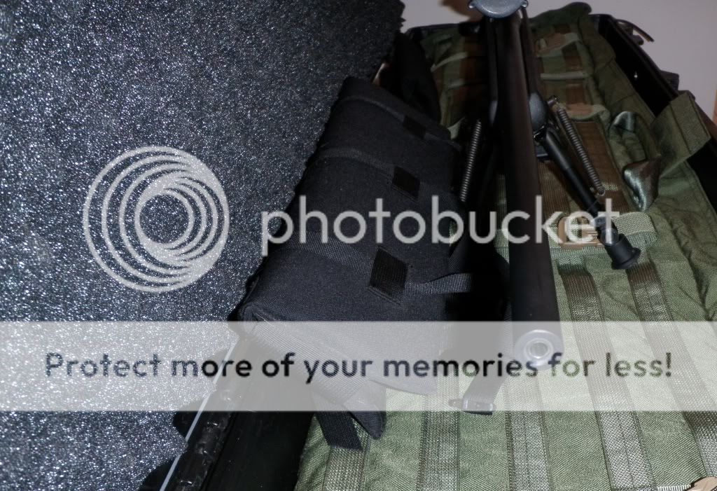

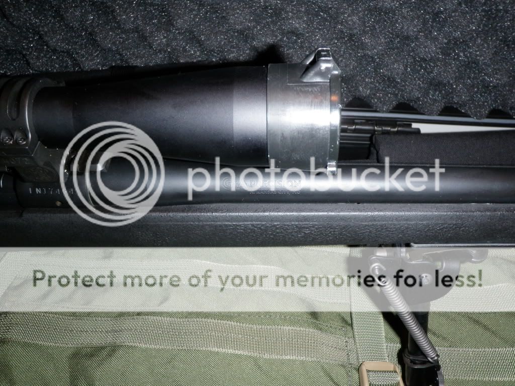

I have had a few people ask me questions about this rifle so I decided to post it. I had this 6.5x284 Norma built by GAP when I worked for FNH USA as a Product Manager. It is a prototype of a rifle series that was not built by FNH USA (a combination of a PSR 1 and 2). We used a WSM magazine box a WSM ejector and STD floorplate triggerguard. The follower is out of a long action (but I cannot remember what model rifle it came from CZ or Kimber?) and was fitted to the WSM box (the factory WSM box will fit a 3.00" round with about .080 room). Magazine cap. is 4 rds. The stock is a McMillan HTG. The chamber was cut to STD 6.5 x 284 Norma on a Bartlin 1 in 8 SS barrel 23.5 OAL with a .705 at the crown and a taper that is .020” over a Winchester M70 Sporter and then Ceracoated. It shoots a 1/4min @ 100 yds. with GAP's hand loads. The scope is a Leupold VX-III LRT with a TMR 3.5x10 40mm, FNH steel rings and a Near 20 MOA Rail. I would highly recommend contacting GAP to do your work custom rifle work. As I am in-between jobs at the moment unfortunately I am not sure I will get to keep this one.
