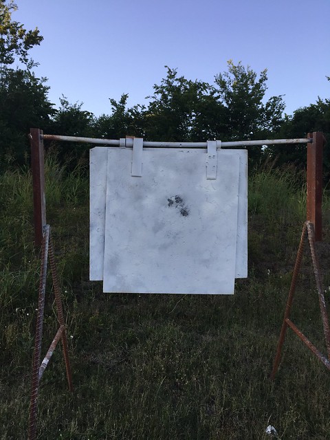

Gain Twist Barrels?
i had to try one in a 40 cal long range black powder cartridge rifle.
the intent was to shoot bullets with the same b.c. as 45 cal rifles with less recoil, so it needed a faster than usual twist to shoot longer than usual bullets.
it goes from 1/26 to 1/13 over a distance of 30".
one of its big strengths is that it shoots bore diameter paper patched bullets, possibly because it causes the paper to strip better than conventional non gain twist.
in fact it has a pp load that is the standard to judge grease groove bullet accuracy by, and none have equalled the pp load to date.
this rifle has only been shot out to 1000 yds so far, but delivers from 200 to 1000 consistently.
what is interesting about these rifles is that they are transonic from the muzzle to 600 or 700 yds.
modern smokeless guys avoid this like a dose of ebola, but designed and loaded properly, bullets can travel through it with good accuracy.
