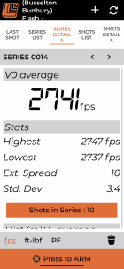

For the 185 Juggs with my new XIT build I am using new Peterson SRP brass, FedGM205M primers, Varget. 30" Bartlein 5R barrel, (new)
43.4grs Varget, COAL 3.023, Elev 4902, Temp 73, Mean MV 2700fps, SD 4.3, ES 9.0
I'll throw up the shot marker pictures and stats despite the laughter and ridicule it will prompt.
5 shot group, and then I pulled out the 5th shot thinking I made a mess of it.
