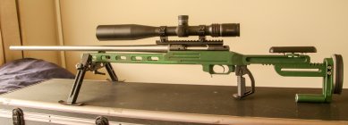

mmm 32in heavy Palma 9 tw...so a 4 power scope and a balsa stock to make weight? PRS with a 30-32in barrel? 28in of light or med Palma, 10 or 11 twist is all you need for FTR. Put the rest of the weight in a scope and decent stock/chassis. Pic is my FTR - 28in 13 twist MAB, Barnard action Right bolt left port, Dolphin Chassis. Burris XTR 8-40 scope.
