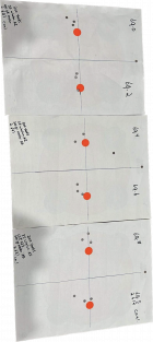

frusterated trying to find a load in 35 whelen improved with cfe 223. target pics added
Savageseven
anyone else have a load that has worked well for them in 35 whelen improved with 200 grain projectile ?
i want to use the 35 200 grain accubond because thats what i have the most of.
the rifle groups a 2 inch 3 shot group at 200 yards with 69 grain of cfe 223 and a GM210M primer .
but im really not that happy with that group. i feel they should all touch at 200 yards or atleast be a half inch group .
with 69.5 grains of cfe 223 im getting 3167 fps with a 26 inch barrel 1-12 twist

i agree thats why i was hoping someone else could chime in and speak from past experience .
no my 69.5 load is not compressed. ive done seating test with this load everything from 5 thousands off lands all the way back to 15 thousands jump. and rifle still seems to not get any tighter groups

so maybe i should try seating with more jump then 15 thousands
2" at 200 yards. It is not a bench rest gun. 2" should be good for hunting deer. I asked someone once what size group do you shoot standing off hand after you have been walking for an hour. Maybe a 15 or 20" group.
All testing was done at 200 yards
Nosler brass , CFE 223 powder , GM210M primers . And 200 grain nosler accubond.
All testing was done in 3 shot groups with
Letting barrel rest between shots.
At 69.5 grains of powder I’m at 3167 fps
Do more seating depth testing. Plenty of bullets shoot best farther off. .020”-.050”. I never tried CFE223 in the Whelan AI but 3100+ seems awfully fast. Try farther off first if that doesn’t do it change the powder or bullet.
i did jump the bullet in seating test 50 thousands are you saying it needs more jump ?
